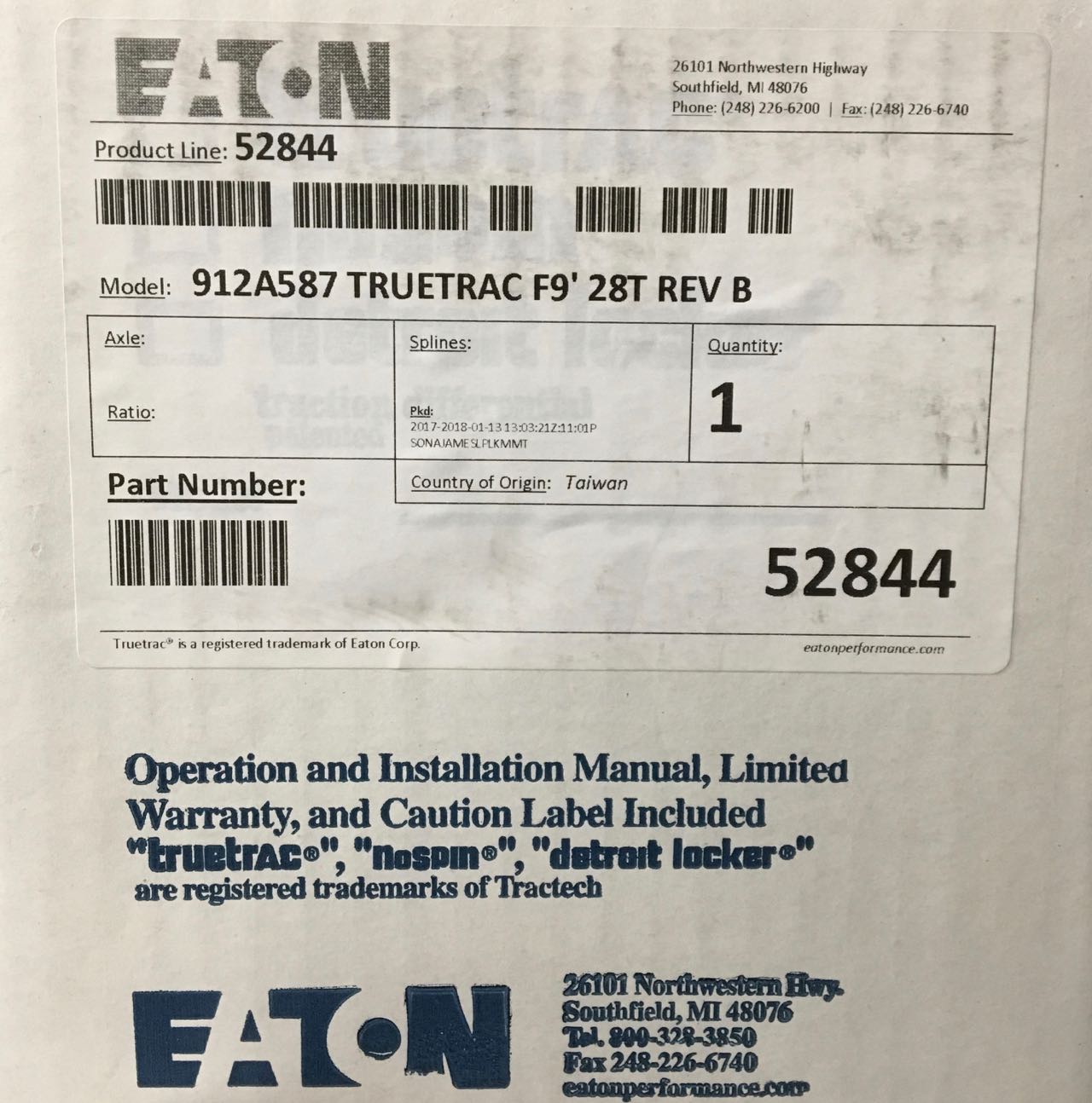

Thanks guys...
eggman thank you for taking the time to put your personal experience down - it helps. If you don't mind, are you running a synthetic gear lube?
I believe the Ford Racing Trac-Lok is a 4 pinion and has carbon fibre clutches, I will have to try to verify.
A Truetrac is slightly more money than the Trac-Lok, but probably the friction modifier will make it close to a wash... a Detroit locker is $75 ish dollars more...
Any one know where these are made?
Guess I am kind of leaning toward Truetrac now.

Post by DuckRyder »
Image :wink:

Post by DuckRyder »
OK:
Is this the correct build kit:
https://shop.broncograveyard.com/Ford-9 ... nfo/22278/
I seem to recall seeing a note somewhere that the carrier bearings were different, but can no longer find it.
Summit Q&A includes the following:
ID on the average 9" Carrier is 1.760, where as the ID on this Truetrac is 1.782,
You will need to use a 102949 and 102910 bearing and race to make this work.
I used LM102910/LM102949 which has 1.7812 id and 2.8910 od,
Maybe it is this one?
https://shop.broncograveyard.com/Ford-9 ... nfo/22279/
