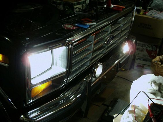

Done it fer two of the trucks now and it should be a mandatory mod for pre '92 Fords.
Some digarams I've made:
With fog lights
With combined high and low beams and a toggle switch to replace the floor switch.

lots of drawings to choose from.i used this one the first time.
not just a drawing, and theres a good explanation if you have not done this type of thing before.
