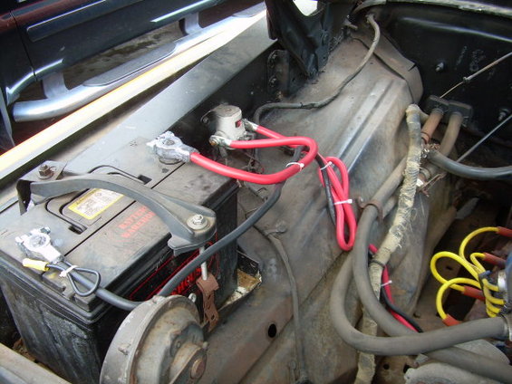

anybody ever think of moving the wires going to the cab from the battery side to an insulator strip and then wiring up to the selenoid? Would this be Redundant?

You would have to make sure the cable from the soleniod to the insulated strip was large enough to handle the amp draw. Very do-able tho. I am sure the loud stereo guys do that all the time.
I moved a few of my wires to the battery post, to reduce a little of the clutter and draw directly off the positive battery stud.
In life many men take the path of righteousness, some take the path many others follow (G.M. owners, for example), some take a more arduous path, some a simpler path. I, sir, took the PSYCO-PATH!!
I took all the wires that bundle power and ammeter in on an insulated terminal. Well I moved all my points to a strip and run a battery cable directly to the solenoid and all else to the terminal along with a Battery + 6 gauge wire to the terminal. 6 gauge will handle 65Amps if it is a rubber coated wire.rjewkes wrote:anybody ever think of moving the wires going to the cab from the battery side to an insulator strip and then wiring up to the selenoid? Would this be Redundant?
I use 4 guage for engine ground to battery and 4 gauge to the solenoid and 4 from the solenoid to starter.
